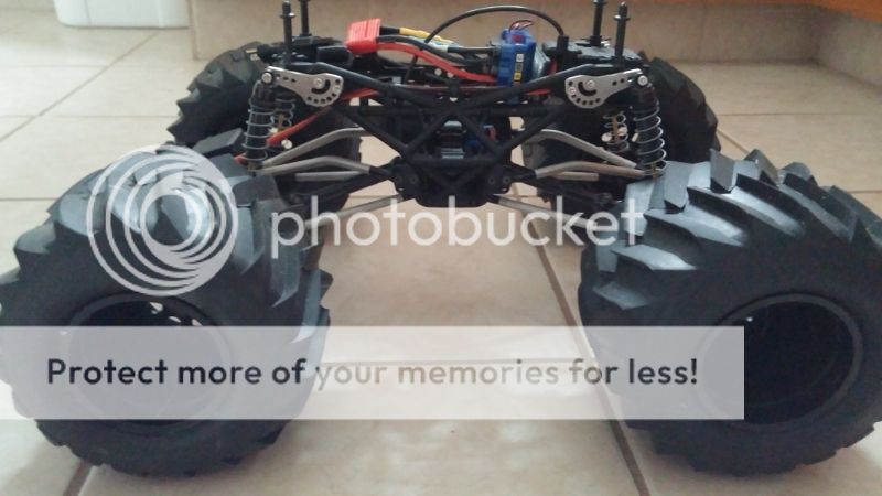

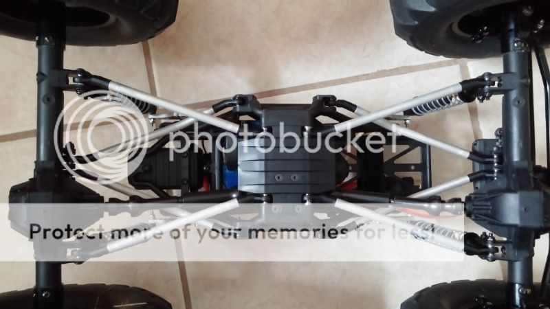

Post by mimtnbiker » Thu Aug 20, 2015 9:39 pm
I built a set of 4-links for the AX10. Didn't turn out too bad. I made the uppers first and ended up being 5mm longer than stock, so I went with it.

Post by andymac0035 » Fri Aug 21, 2015 9:58 pm
That came out pretty darn good! :thumbsup:
