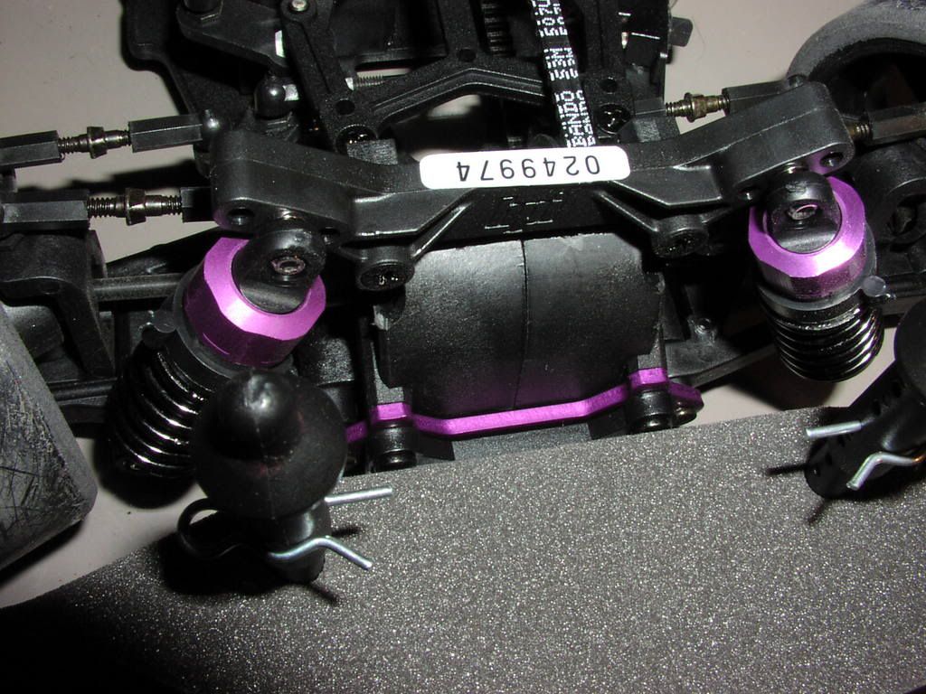

It's been a while since I messed around with the my Sprint 2 Flux.

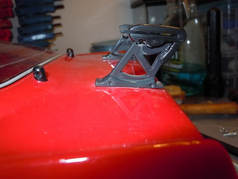

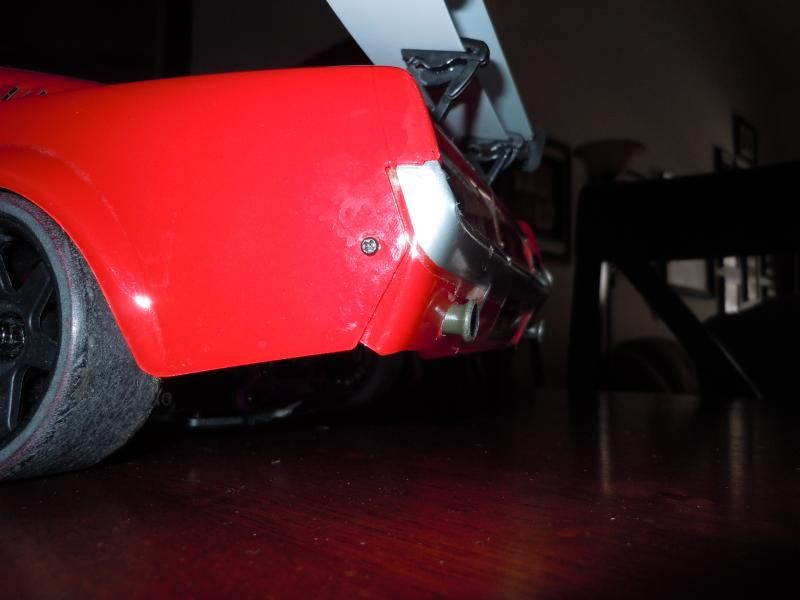

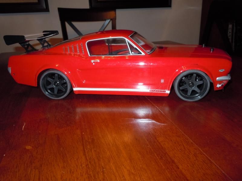

I was doing some internet searches for ways to tighten up the belts and get more room for the battery slot as the belt runs over the top of the battery. I found a couple fixes and proceeded to make some changes. I also decided to put the stock body ('66 Mustang) back on and fix the wing that broke in a crash and add some custom tail pipes while I was at it.

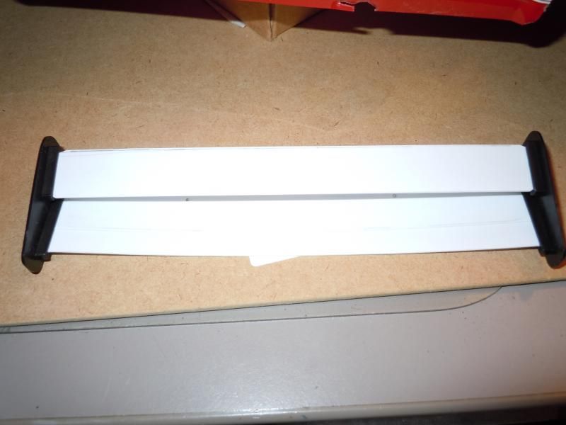

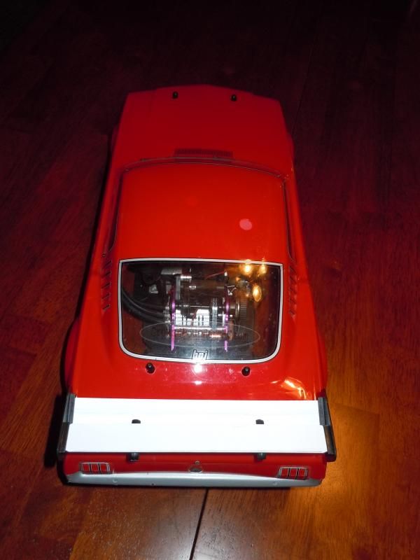

For the wing, I used some Plastruct sheets I had for my models. The aluminum fins were all mangled and could not be salvaged the final results turned out well and it looks good in the white. :wink:

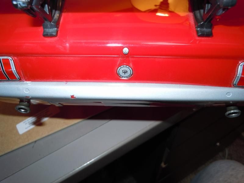

I had some ends from 1/4" break line that look like outlets for exhaust. Reamed some holes in the body and hot glued them in place. They really add to the tail end and look like the trumpet style tips that were on the early Mustangs.

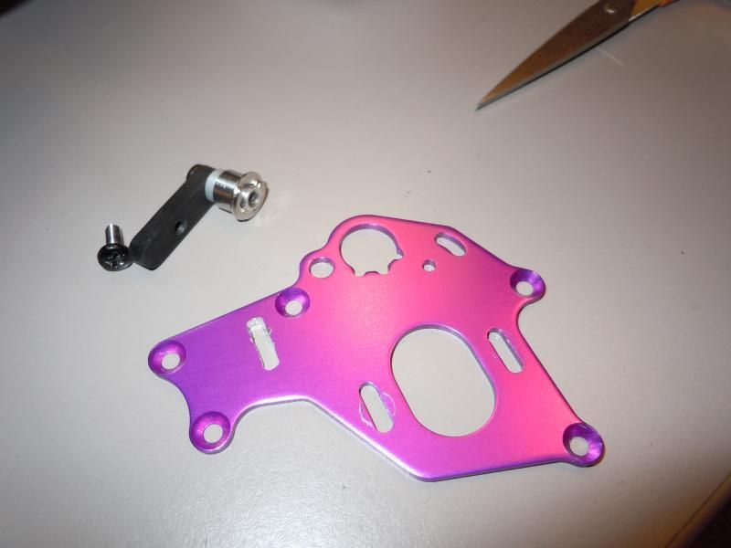

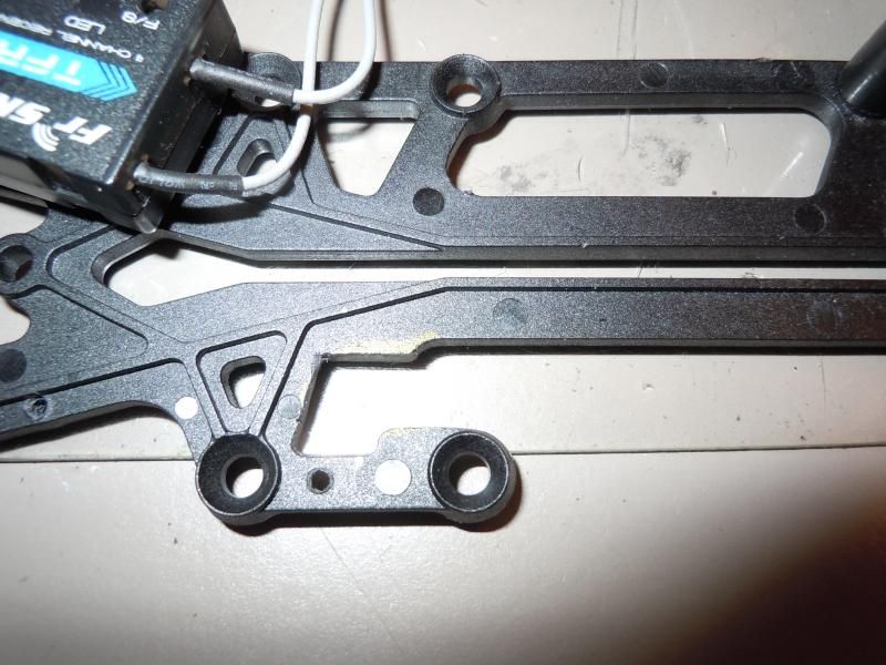

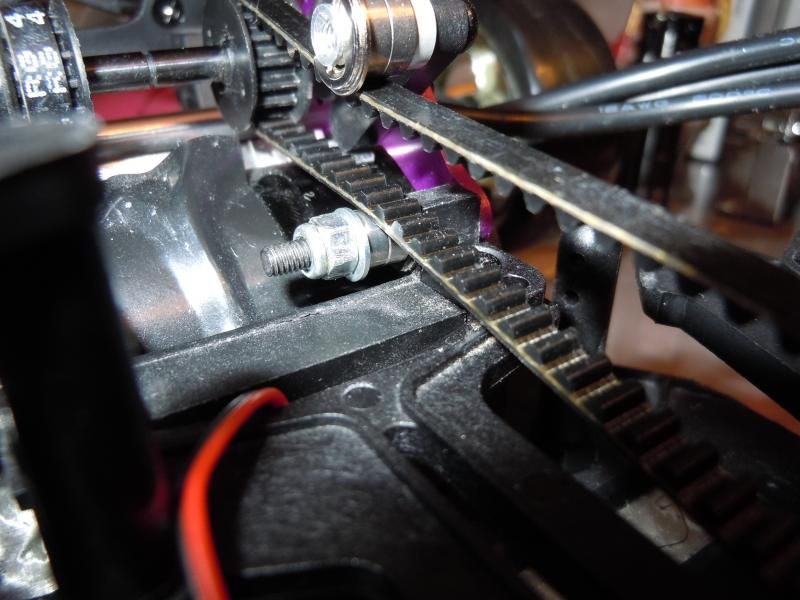

For tightening the rear belt, I had to cut a additional slot in the motor plate and used an extra front belt tensioner (Part # 86041) to tighten the rear belt. It works really well.

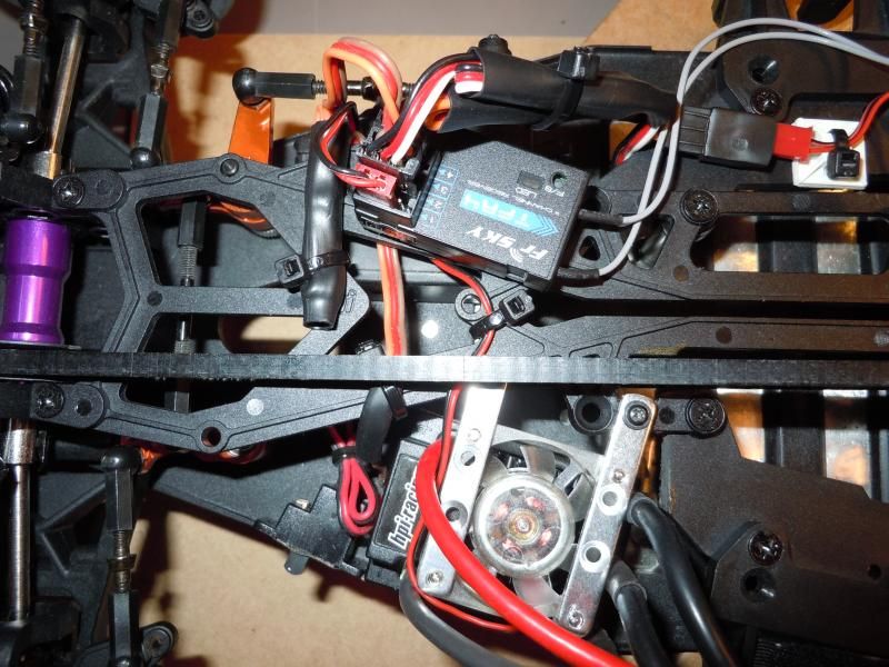

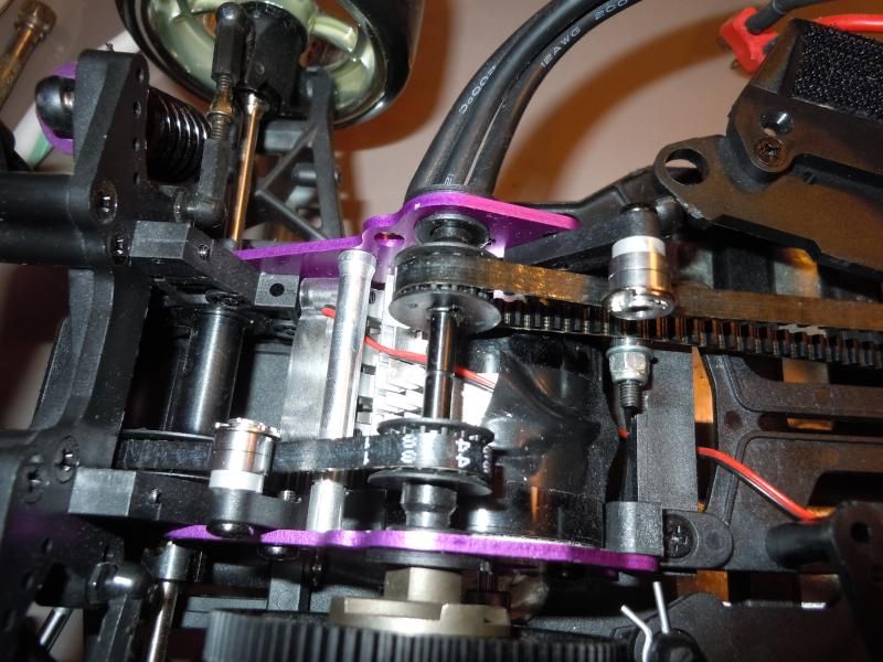

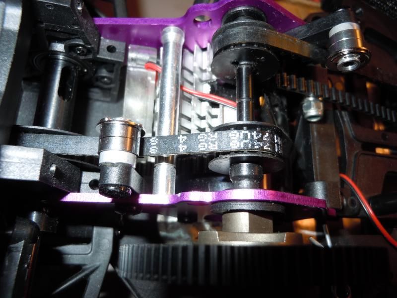

To increase belt clearance, I used a M3x24mm flat head screw to replace the stock bulk head screw. Use two 3x6x2.5mm bearings and two m3 washers as guides for the belt. Sequence of parts is as follows: M3 washer, two 3x6x2.5 bearings, M3 washer, and lastly 1 M3 locknut. This really increased the belt clearance and doubles as a belt tensioner.
Also, when you increase belt clearance, you need to notch out the upper plate a little so the belt does not hit.
Lastly, I redid the entire electronics wire routing and made them look more presentable and not so cluttered looking. With the belts, it becomes a pain to get everything secured so nothing is hitting on them.

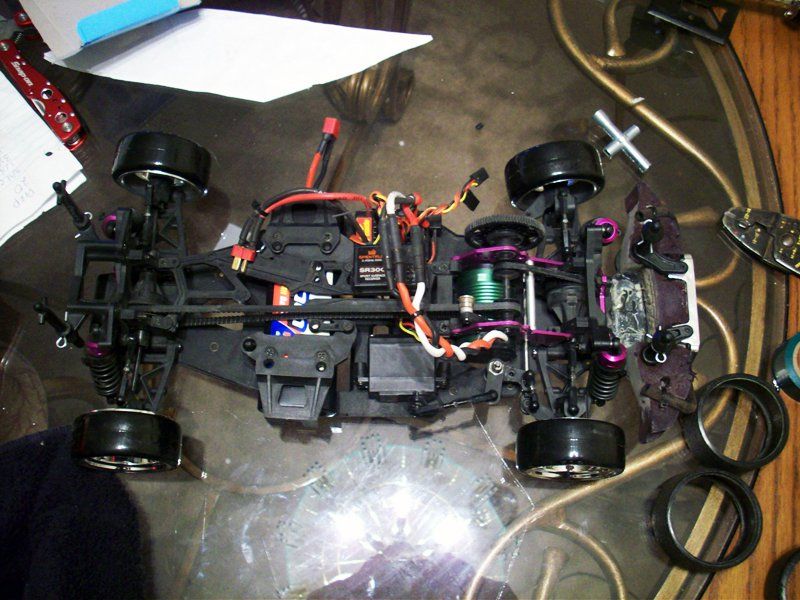

In its simplest form you are just swapping the lower plate front to back.
here is a pic. This was when I first got it together, I ended up making a couple more changes after this, an idler for the belt and got a new top plate that was less chopped up.

Post by SFC K » Mon Jan 19, 2015 11:03 pm
Interesting! I would have never thought of that. Steering looks like it would be a trick with my fan mount on my motor.
