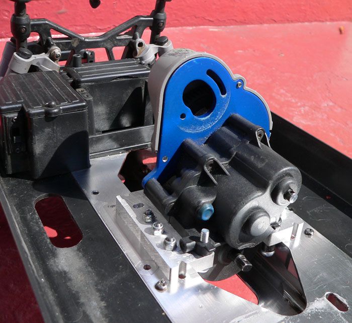

Finally got my transmission mounts in. Now I just need to source some driveshafts/dogbones and drive cups and I'll have a roller. The Maxx tranny is shorter than the MGT's, so I need new driveshafts. I need 114mm up front and 96mm in back. The longer half shaft from the Mad Force axle (Kyosho MA024 - Drive shaft (114mm)) should work up front and a Hellfire front driveshaft(96mm) for the rear. I know what I need, but my piggy bank isn't jingling ](*,) .
Thank you, SicNme!! I really wish I could get them anodized, but that's more time and money.
I'm loving it already. Had to make a short trip to Ace Hardware for longer 4mm screws to secure the tranny.

Re: Enter, Brushless MGT
Post by SFC K » Fri Oct 04, 2013 9:26 pm
Those look really good! I hear you on the money in the piggy bank thingy... :wink:
Looks like you got a bead on drive shafts too. Keep it going!

Post by sicNme » Wed Oct 16, 2013 12:46 pm
No problem on the mounts buddy. Glad they worked out for ya.
