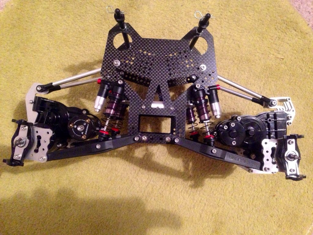

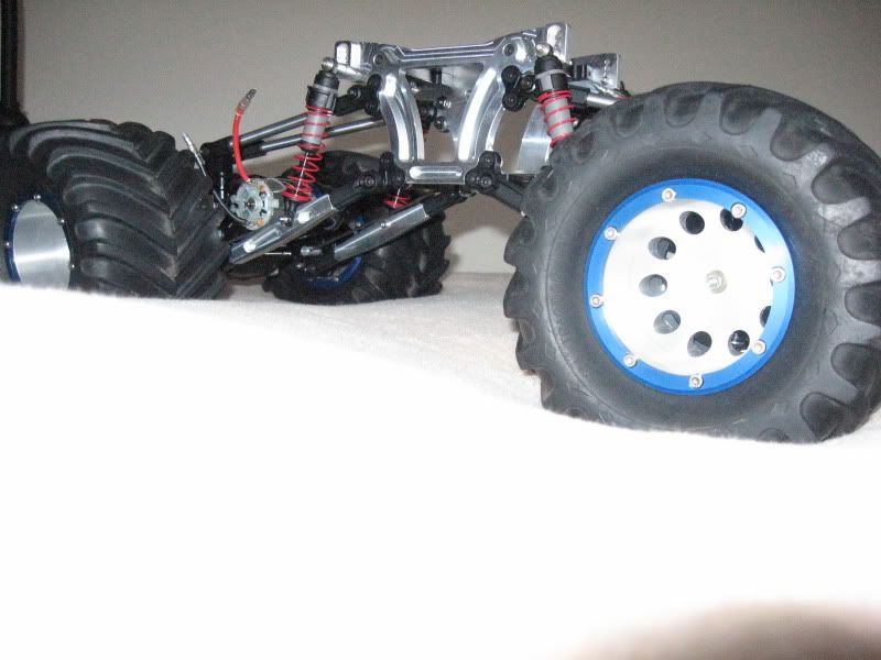

Shocks are a big subject as Andy indicated. I do like the Gmade ones but every set I have ( in various types and lengths) leak, despite careful building and use of associated green slime on the seals. I've never had a set of Tamiay shocks leak, even the cheapest plastic CVA ones (but those are not good enough for a hard driven clod project) . Traxxas e max shocks are a cheap choice that work well (look for US eBay sellers who part out kits cheaply, normally sold in sets of 8 so you can sell 4 in the UK and get most of your purchase price back !), and just upgrade the top caps to metal ones when you really start big jumps. Proline shocks are good but comparatively expensive - well regarded but you're looking at ca £80 for 4 in the UK marketplace :(
Traxxas shocks on a otherwise std Clod
And on the Gmade spider
Gmade piggybacks on my CPE terminator
Also consider in your design whether you want shocks directly linking the lower arms to the chassis, or a cantilever design. either way the axle will move in an arc relative to the chassis as it moves around.
wheelbase will also affect the stability and turning ability - most 'racing' Clods are still around the 13" wheelbase, some conversions alloy 11.5" right up to 16" (or more). 2 wheel steering on my Spider Clod doesn't make for a very manoeuvreable beast !. You potential choice of body may also determine where you want to be with wheelbase. Note a lot of the T/E Maxx bosies are nearer 1/8th scale, fairly wide and therefore tend to be set high on the chassis to allow for the wheels - fittign axle wideners is one answer , that helps stability in the corners, but also increases load on the knuckles/hubs
