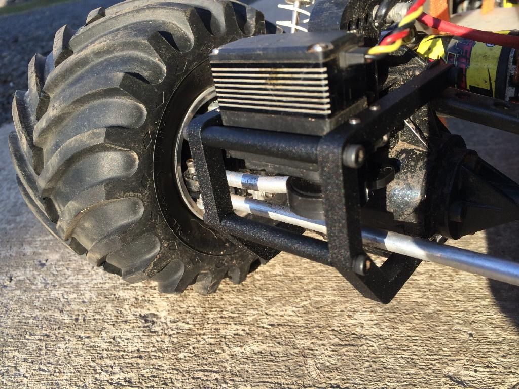

rex21
Posts: 344
Joined: Wed Dec 05, 2012 1:42 pm
Location: Star Prairie, WI
Re: Two Clod build thread
Post by rex21 »
The only one I know of that makes themcurrently is on rccrawler. He makes them out of steel and I hear they are nice. His name is mattzilla.
I made my own, the way I wanted them. You can find them on ebay from time to time.
I prefer this style for the protection it provides the servo and steering links, and I have bounced it off of tons of stuff.
They do not look this good anymore:

Wow... I really like the look of that. Nice job on those.

I'm a big fan of the bumper/servo mount as well. I have a couple of JPS bumpers that I picked up second hand, I also have a few of the MattzillaRC bumpers. I bought a pair only a month or so ago. I contacted him on his FB page. I paid $76 including postage to Australia. Pics can be found in this thread: viewtopic.php?f=46&t=28495&hilit=mattzilla
There is also the aluminium version that you posted the pic of. They can be found on Ebay; http://www.ebay.com/itm/Aluminum-Axle-A ... 3aa67e68dc
