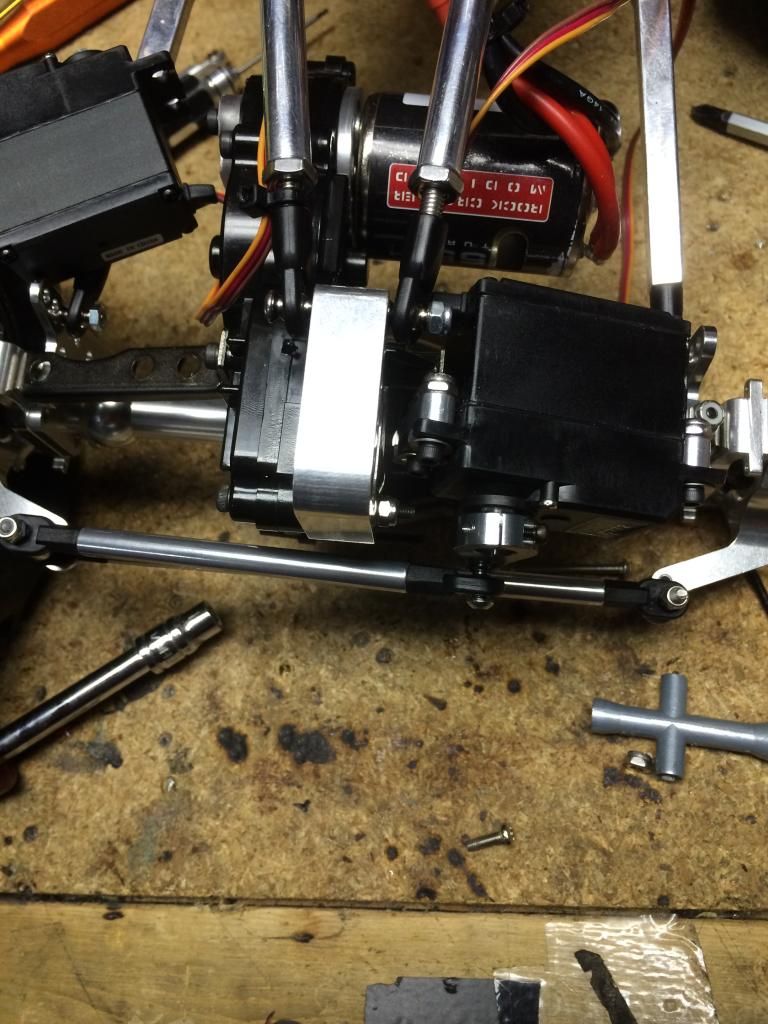

Looks good, but can you mount those servo's further back? You want to get that upper link as parallel to the lower link as possible.

Post by rknaub » Sun Aug 10, 2014 12:47 am
SFC K wrote:Looks good, but can you mount those servo's further back? You want to get that upper link as parallel to the lower link as possible.
Can't go back any further, but I'm gonna try and put the drag link behind the servo horn.

Post by rknaub » Sun Aug 10, 2014 8:31 pm
Changed servo mounts, RCGuy axle mounted. Protect those cheap servos a bit!

Post by SFC K » Sun Aug 10, 2014 8:52 pm
Looks much better with that mount. =D>

Post by Irio - esos » Mon Aug 11, 2014 5:11 am
Love the gecko chassis but it will be hard to get your links parallel with it. The mounting spots on the chassis are like 2.5" apart while the lower mounting of the links on the axle vs the upper mount points are 4". If you move them to the upper holes, the ones below the tube braces, it reduces them to 3" but then you get that rock crawler style lean under acceleration, and still have a half inch difference. Went back and looked and you might have better luck with those braces on there but you'll still be mounted kinda high on the lowers.

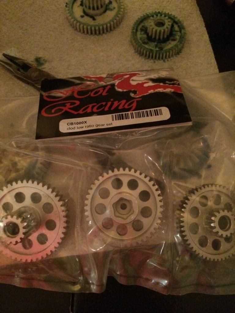

Got some proper gears installed, front and rear. Couldn't get epoxy, shoe goo, or JB weld to hold the diffs together with these heavy mud slingers. Plus, I love the lower ratio gearing! Really starting to love this truck, although the only thing that's still on it when I got it is the chassis. :)

That must be a real crawler now. What is the final ratio with those gears?

Post by rknaub » Sat Sep 06, 2014 10:32 pm
Sixtys Guy wrote:That must be a real crawler now. What is the final ratio with those gears?
75:1 with the 8T pinions I have, can go 100:1 with 6T. Amazing torque! And these cheap rc4wd 55T motors are pretty good! Not a real fast truck, but that's not what I was looking for with this build. A basher/racer will be my next build... About to call this one done soon!
