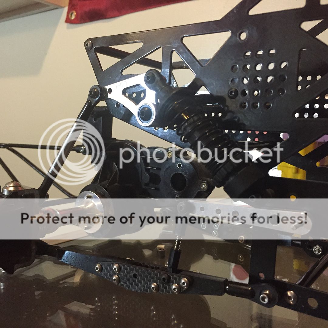

Well..... Here is what I came up with. Only had time to get one done last night due to so much time invested in trying to figure out the best and most efficient way to install the cantilevers. So I ended my night with this, and woke up this morning after a cup of coffee I hit the bench and got it done in no time. Still have some small items to work out. Most likely will be putting a vertical servo mount on it. The front push rod binds on the bta servo mount :cry: I could just hack it but that's not at all how I do things.
I'm not sold on the sway bar setup just yet. May switch back to the ones I had before. These seem a tad long
Re: Mopar Super Stallion
Justin, what is keeping the stabilizers from hitting the bottom munt for the shocks?

The shocks are fully compressed right before the sway bar arms touch the shock cap. Believe me I fought with it forever before giving it just enough clearance lol

Got this pig finally finished! Improved the the cantilever setup a little more. Changed over to vertical servo mount ( front right push rod wouldn't work with bta) changed out the springs for more rebound, added a few delrin cross braces. Added 3 zrp esc plates and did away with the big bulky center plate. All in all I'm more than happy with the outcome of what I was trying to accomplish.
And yes Andy, those are Revo rods as my upper links. :wink:

1Badclod85 wrote:Changed over to vertical servo mount ( front right push rod wouldn't work with bta)
You probably could have used the mount though, and just repositioned the servo like mine is.
Actually those are tow links. :mrgreen:
The pushrods don't have adjustment hexes on them. :wink:

You know what I meant smart arse! I feel the vertical mount works better since I added spacers to the push rods. I tried everything to make the bta setup work. It was just no bueno.
