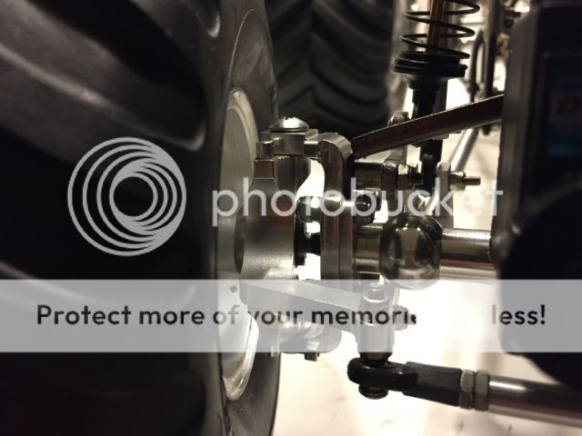

While I am at it, I am also going to try limiting the rear steering a bit. I tried something similar, I think about a year ago, but the limiters I used were way to small and the location allowed them to have a good amount of torque applied to them from the knuckle. Needless to say, they didn't last long.
This setup uses the screws used to assemble the axle tube. The are way beefier than my first attempt. I hope these work.

KingKlod wrote:While I am at it, I am also going to try limiting the rear steering a bit. I tried something similar, I think about a year ago, but the limiters I used were way to small and the location allowed them to have a good amount of torque applied to them from the knuckle. Needless to say, they didn't last long.
For limiting the travel have you tried to run a really short servo horn/disc? You could use one of the generic discs that RC Planes use and put the mounting point as close to the center screw as possible.

132NHAF,
I've consider the setup you mention. The one thing that keeps me from doing it is a lack of servo saver.

KingKlod wrote:132NHAF,
You could always drill a hole just a bit closer to the center. I realize there is a lip and a potential for binding with the steering link, but you could experiment with an older (read: broken) saver.

^^^ That's what I did.
Taking a kimbrough #124 and drilling from the backside, put the hole right up against the shoulder of the round part.
Make the hole slightly smaller than the screw you will be using, and thread it into the hole from the front. (just the plastic from the servo saver holding it, so don't over-tighten)
I've been doing this for a while now, works great for me.
