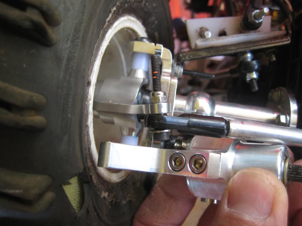

that being said, i do have a clod with full aluminum gearboxes and a clod with plastic gearboxes and integy tubes/jps knuckles (front) and hot racing knuckles (rear)...and i just got a set of integy gearcases, and JPS tubes/knuckles, for a truck i plan to build this weekend...
the integy stuff works great...the integy gearboxes are heavy, much heavier than the JPS counterparts...but the tubes and knuckles are similar...i never had a problem with any of my integy tubes/knuckles...i wont buy any hot racing tubes/knuckles again...the tubes wore funny in the kingpin area, even though it had bearings, and the steering arm on the knuckles bend easily...they aren't as beefy as the integy/jps units...
here's a pic of the JPS knuckle and a hot racing knuckle on the truck...

That is an awesome write up. I have been thinking of getting the hot racing tubes and knuckles. That's good to hear about the integy stuff and the difference between integy and jps.
After looking t the pic of the knuckles I'm thinking I might have jps units. Mine are bigger like that and bolt on.
