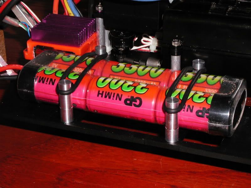

WELL!!!!
after much procrastination....i decided ..i had to finish up this truck no matter what.....
so work on draggular II started back up again...
this idea of laying the hauler tranny on its side came about when Bloodclod and i talked about "how" the CG could be lowered on a hauler....
so i did a rough placement (on a scrap piece of G10) with the tranny and batt to see what kind of width this idea would take on a chassis...and would it fit under the shell.??....
after finalizing the layout...i used another bigger piece of G10 for the actual chassis plate, milled out areas where i felt that didn't need to be there so as to lighten the G10 plate as much as possible. ( i'm surprised that 3mm G10 weighs as much as it does...)
initial intention to use hobao batt holders on the chassis plate but due to an oversight.....i realised the batt could slide into the holder coz the "Z'd" frame rails were in the way!!!
so had to toss out that idea.
After looking around on the internet a little, i came across the CRC "carpet knife" pan car chassis that used O-rings that secured the batts in place....
so after painting the chassis plate black,.
..i fabbed out some O-ring posts to serve as batt retainers......
Mon Jul 03, 2006 12:34 am
Profile WWW
Joined: Mon Apr 26, 2004 12:30 am
Posts: 178
Location: singapore
Post
at this point, it was pointed out to me ( by none other than the great BLOODCLOD!!!! ) that the entire chassis looked as though it would "taco" the moment i hit sumthing head on...( yes my driving skills are not exxactly up to standard )...so i had to do some sort of bracing to span the front and rear ends of the chassis.
initial idea was to use a long link with ball ends to "brace" the front and rear sections......
BUT that wouldn't be "trick" enuf right?....so after looking at a RC heli hanging in the LHS......i came up with this.
its actually in 3 sections (front/mid/rear) ONLY coz i didnt have a piece of G10 that long. :lol: ..but on hindsight, i think it looks nicer this way rather than having one long piece.....
here's what it looks like under the "new" lexan shell, why a new shell?...erm...coz the old green one looks too short on this "slightly longer than stock" chassis.... :rolleyes:
not too "shabby" a fit, considering all this was "eye-balled" eh? :imslow:
