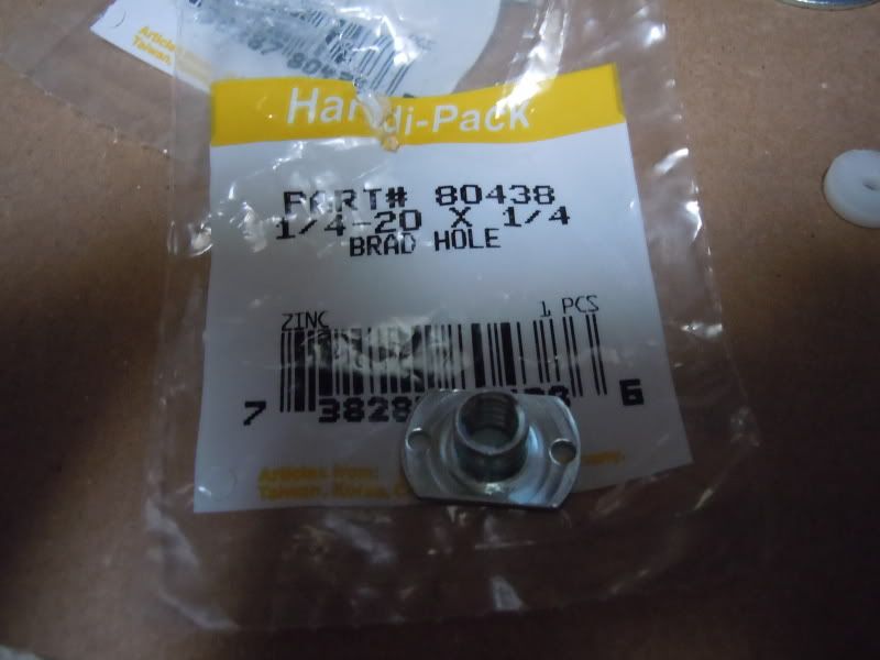

So seeing how Andy built this section for Charlie and me... :wink: I will share my custom body mounts as seen on my CC-01 thread.
So go to Menards or your favorite hardware store of choice and pick up part: Brad Hole’s, Part #:80438. Also while you are there pick up some 1" washers if you don't have any laying around. I had some so I took the 1” washers and drilled holes to bolt them up to the Brad hole adapter for more surface area to attach Velcro to the top. I drilled a hole through the shaft of the Brad hole button so I can pin it on the body post. Attach velcro to the top and your set.
this could work for both top mount and side mount if you don't want holes drilled through your body.
These have held up really well on my cralwer with no breakage. I hope you like them... :wink:
