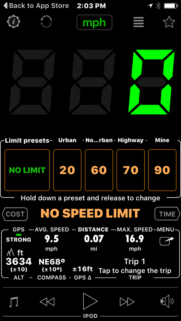

I can confirm a 3s with stock silver cans, stock gears, on a traxxis speed controller all aboard a clodbuster at 16.9 mph,
I can't figure anyway it could be more perfect! Thanks to all the time and input from the people of this forum,, I read it twice, maybe three times, bought it all once and it runs perfect! My new build will be posted down the road,, ( on a slow monthly contest ) lol but here is the proof on the speed
Sit down, strap in, shut up and hold on!
