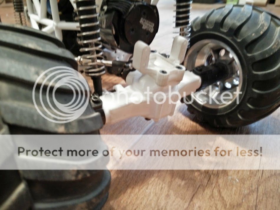

So a look at the new Chub knuckles for the mmt I need to do a minor design tweak so 3mm screws can be used over the PITA mrc ones that at this size just love to scrip easily >.< And add a indentation for where link mount screws (or shock mount with integra axle) go so they don't push the chub around.
Things are slowing down right now but i'm debating on putting the chassis open on beta so you'll just need to provide a mrc/slick rock as a donor an use your own mrc trans plate or 1/16 traxxas trans combo. This will also help me with hugely with feedback an also just getting more of these out there was at the cactus classic last week an some racers saw it an were seaming really thrilled about the truck.

Those look nice. Did you glue two hexes together to push the wheels out further? Suggestion, it appears you have a lot of room on the backside of the hub. You could increase the diameter size of the bearing on the back side to help dissipate heat and the bearings will last longer.
I think you should open up the rest of your parts on Shape ways. I could see some more potential builders of your creation in the future. :wink:

Yeah I did glue the hexes together their about 11m thick or so. I could put larger bearing in I do need to revise the design some so I'll look into bigger bearings!

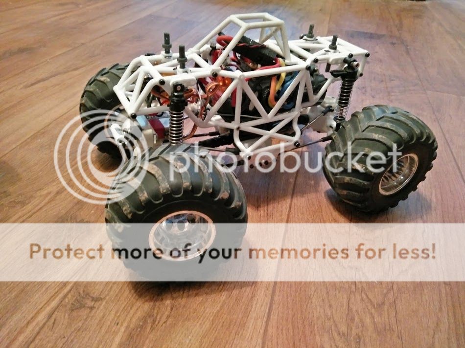

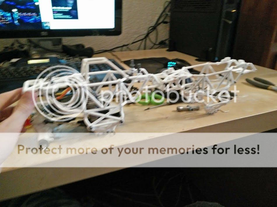

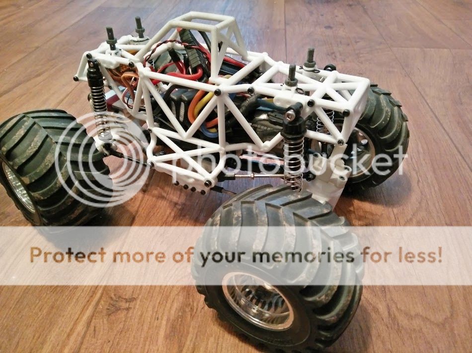

New chassis has arrived with a 3.5 version of the axle to test out on the rear. definitely more room in the chassis now able to put the glitch buster an receiver in the nose section and have more room for the esc and batteries to be actually set in place and not zip tied!
new in bag
blurry side by side of the old an new as you can see the new chassis is just a bit taller
swap complete the batteries are actually sitting on the mrc trans skid so least I have a good idea of how to make a battery box now!
everything fits a whole lot nicer
shot of the experimental v3.5 axle which flips the pumpkin 90o though installing the pinion bearing is a little tricky but doable
If first you don't succeed.. redesign it! an make it succeed!
