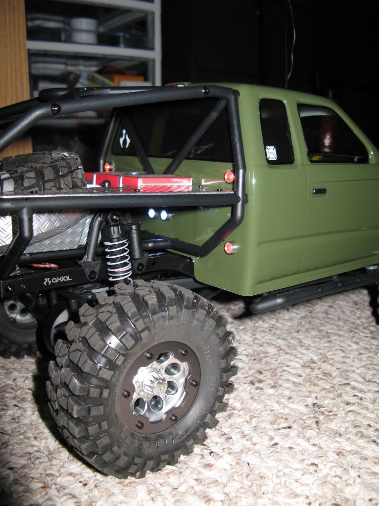

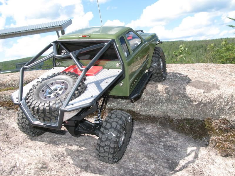

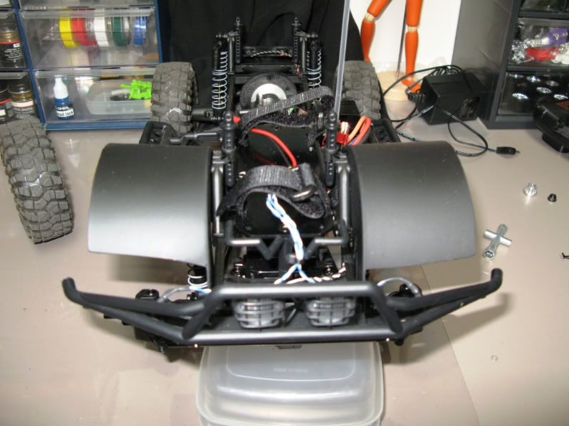

Thought I'd share my ride I have been tinkering on. I did buy the RTR version with all plastic links. alread swaped them out for aluminum links and added 4 link trusses to the front and rear axles. I also added some wheel wells for the front. Just replaced the stock radio gear for 2.4ghz so I could ommit the antenea from sticking out of the hood. I also added extra lights and moved the esc to a better location on the chassis.
These are fun to drive and the sky is the limit as to scale accesories for them.
Here are some pics.

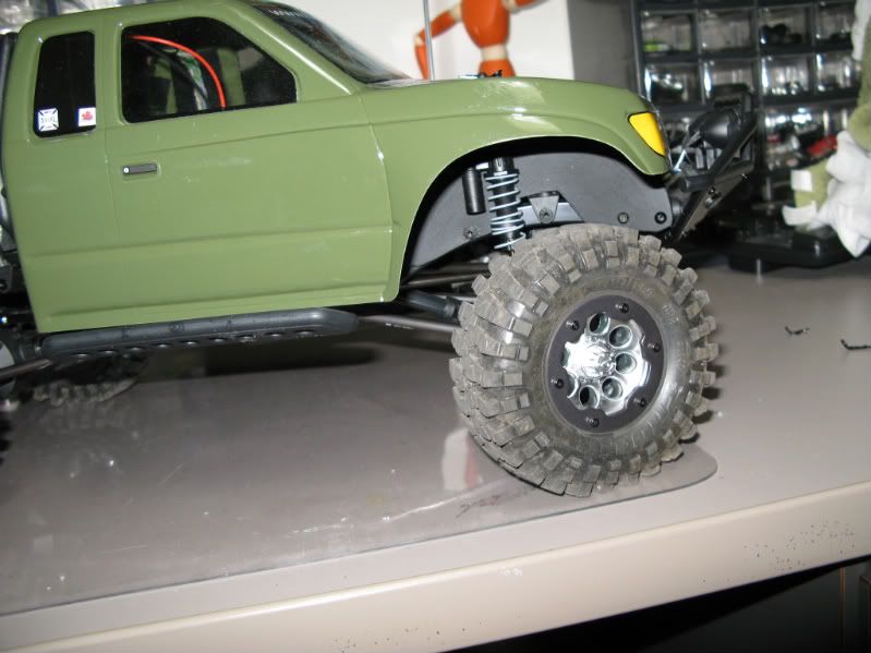

I like the spare tire mount on those.
What did you use to make the wheel wells?
Re: Axial SCX-10 Trail Honcho
Post by SFC K » Sat Jul 24, 2010 3:25 pm
I used the CD-R clear plastic cover that holds the blank CD's. It worked perfect and was the right diameter. Once I was happy with the shape I scuffed them and painted flat black.

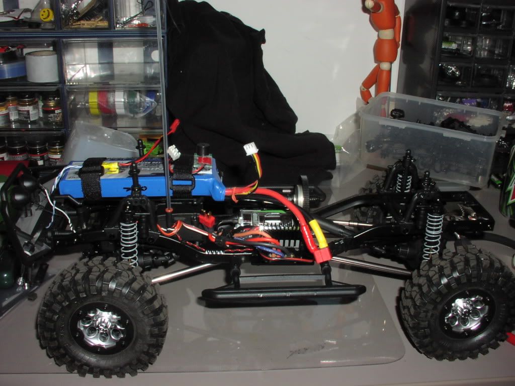

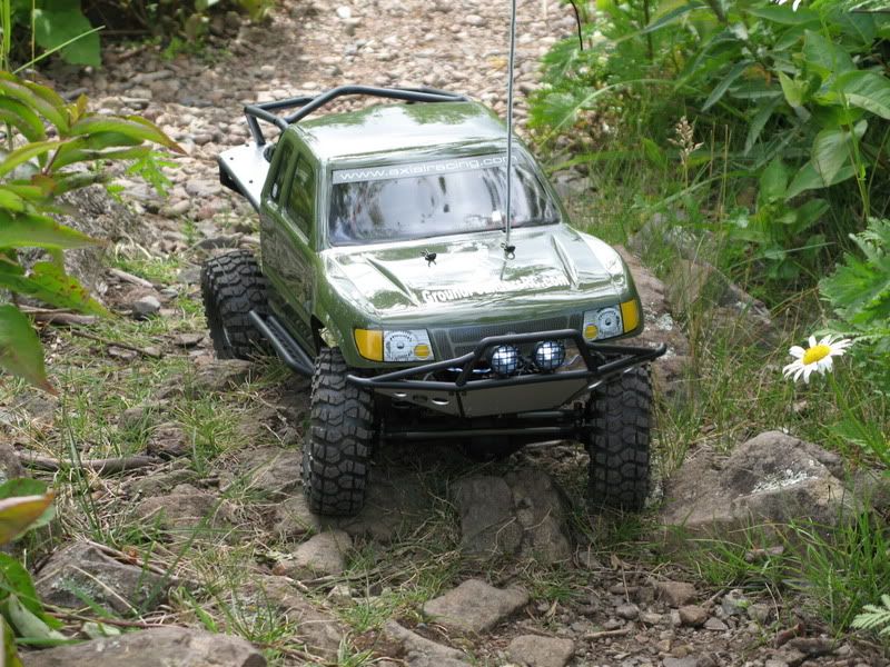

I thought I'd share some photos of my SCX-10 Honcho RTR. Seems interest in Scale trucks has been sparked.
So far to date I have upgraded the TX/RX to 2.4GHZ.
I also added a new mount that I made for the ESC; too get it lower on the chassis.
I also converted the stock plastic 3 link to 4 link trusses front and rear.
A ton of weight to the wheels, this helped for CG and traction issues.
The stock shocks seemed a little on the soft side. I added internal springs to each one of the stock shocks for better shock travel support for the heavy rig.

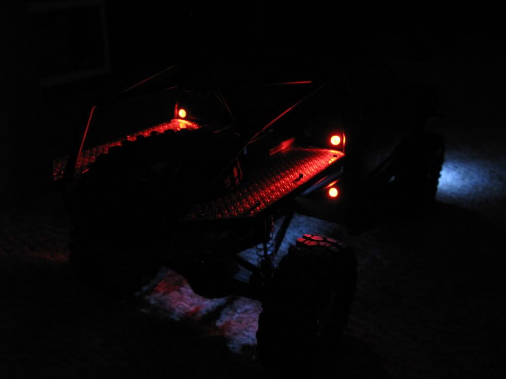

I also added some more lighting for some night time driving.
I made some front wheel wells for the honcho body out of old clear CD holder covers. These were a pain as you have to measure each side separate. It took 4 covers to get the right shape. Over all I think they look great and ad to the scale look.
Lastly I added some Vanquish aluminum shock hoops. They stiffened up the body mounting locations and look trick too. No need for cross braces with these. I did have to strip the anodizing off as they were two different colors (Blue and Orange) when I got them. Now they are silver.

I like the lights.
