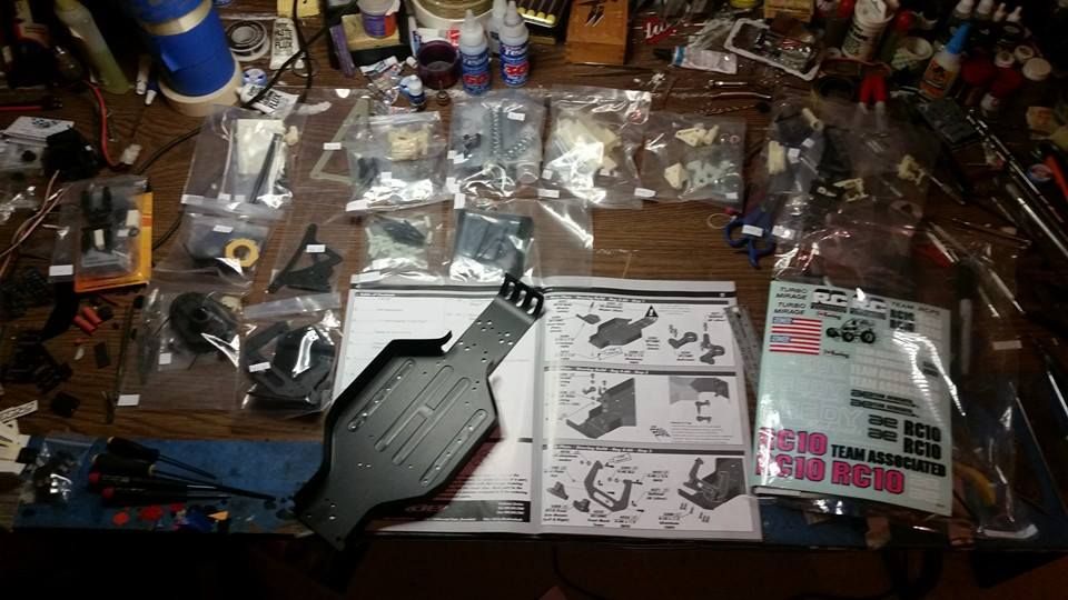

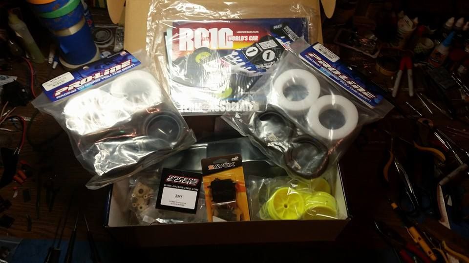

The box -
The open box -
Getting started -
