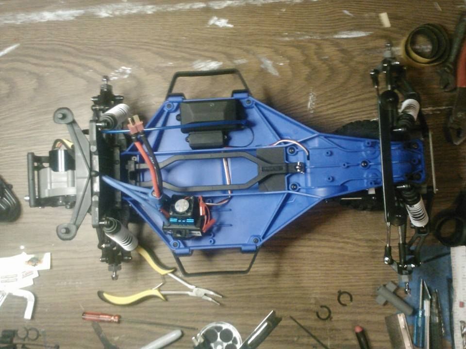

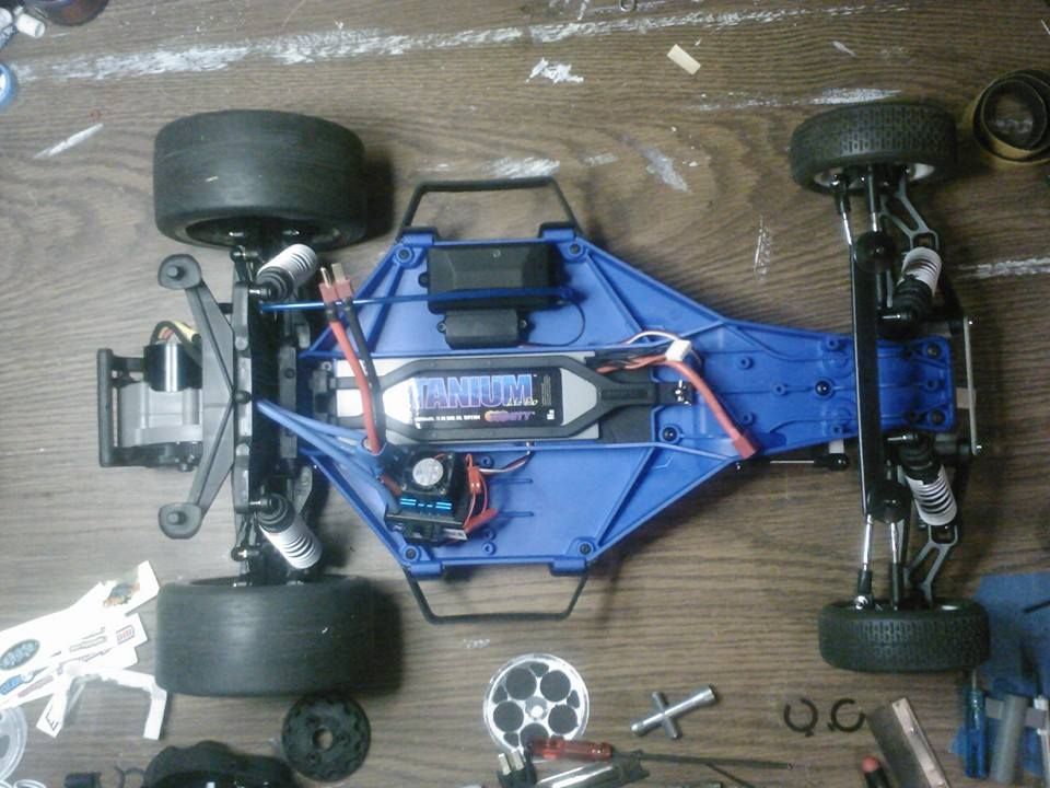

here is the new setup -
Chassis -
Traxxas LCG kit
Front -
Pro-line Protrac front arms
camber links are the old stock rear links (direct fit)
tie rods are traxxas Slash ends and HPI M4x83mm links (need 3mm or so trimmed off total) as they bottm out and have a tad to much toe-in but it's tolerable to me
stock LCG kit springs w/ 1 upper spring cup flipped and 1 small preload spacer
Still need to figure out a hex system for the front so the wheels are easier to get on/off

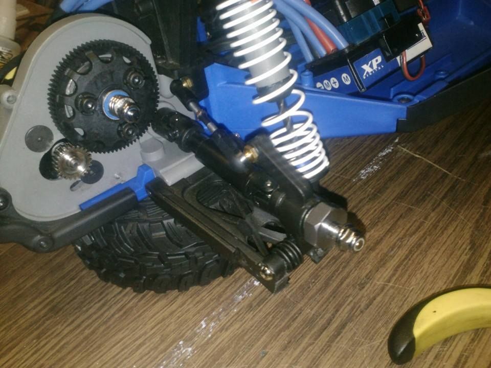

Rear -
stock lower arms (ends cut off to nitro shock mounts/ 16-18mm) - 1/8" drill bit used in nitro shock mount (through both tabs)
Arrma pnAR330144 hinge pins through uprights
Tamiya shock pistons used as spacers for rear uprights (moved wheelbase forward)
Tamiya 28mm turnbuckle/ rod ends/ 5mm ball studs - a 34mm or so link and 19mm ball ends would be better as these barely work
drive shafts cut over 1/2" (trim as needed)
STRC Slash 14mm hubs
Slash Orange -20% springs no preload
0 camber
PICS! I'll be painting the body this weekend pending I like the Purple I got for it..

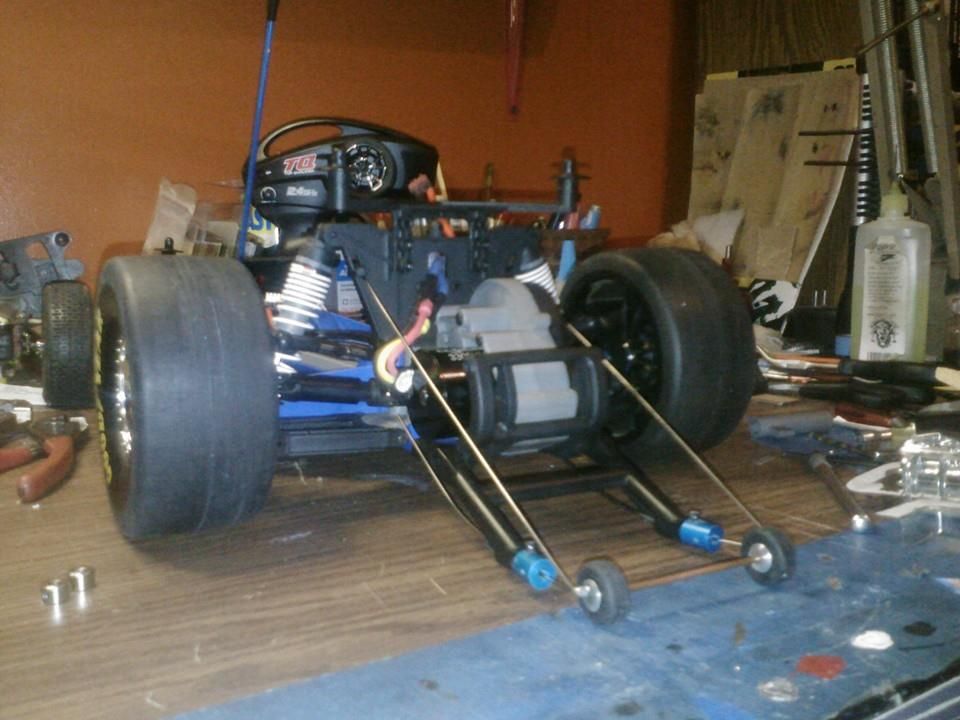

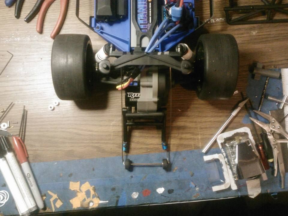

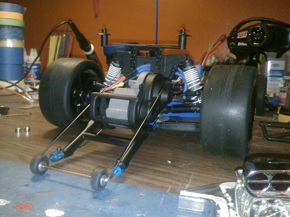

The wheelie bar I made has a spring action just like a 1:1 car so if it lifts the front tires the wheelie bar will not slap the ground - undloading the rear tires. I will look into that wheelie bar though.. If I get more power in it I will probably change to 32p gears.. this should be good for now..
PICS!

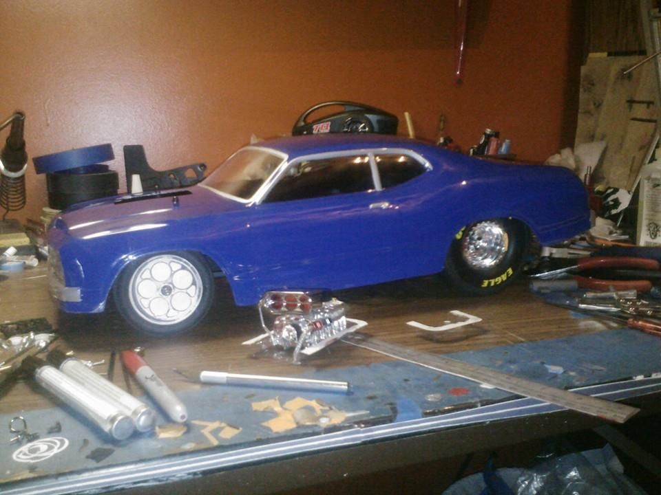

TEASER! It's not done yet, still needs a cleaning and detailing on the outside, as well as make the stock Demon decals that go down the side of the car - looks Blue but is in fact Tamiya Purple - looks SICK I think!
2 RC10's, 2 Losi's, 2 B4.1 Worlds, TLT-1 Grave Digger,
Re: turning a Traxxas Slash into a on road racer
Post by SFC K » Sat Nov 08, 2014 8:17 pm
The wheelie bar looks great and so does the paint job! Hurry and get it finished. Snow is coming on Monday. :mrgreen:
