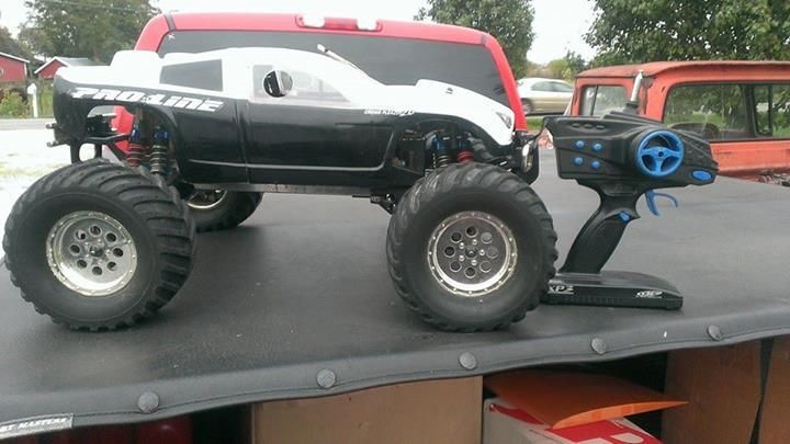

Guess who has another MGT coming :D. I traded a Castle Sidewinder 4600kv Combo for it. It has aluminum knuckles, aluminum a-arm mounts, aluminum shock tops, and aluminum body mounts. Forward only trans conversion. Radio and receiver included.

My truck came in todayImage!! I feel like I made out like a bandit. I think I might just buy a motor mount finish this truck up first. It's got all the goodies I was going to buy. All I need now are aluminum front+rear gear boxes. The front and rear shock towers are both GPM. I may get those reanodized in blue to match the rest of the blue parts. He mentioned aluminium steering knuckles, but I did not expect to find 4 of them.
Surprise!! Surprise!!(Gomer Pyle voice) He never mentioned the aluminium steering kit($60) \:D/ !!
