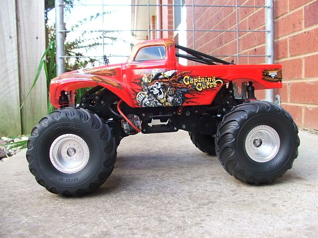

Put on the Traxxas 'Captain's Curse' body and the MJ wheels. Amazingly the body mounts match!!! =D> Well, sort of..... I swapped the front and back mounts around and then turned the 'new' front mounts backwards. Then they lined up perfectly! I used the MJ front wheels. They didn't have as much offset as I thought they would, so I had to install my Junfac wheel wideners. As luck would have it I already had them and they fit perfectly!
Pretty happy with how it turned out......

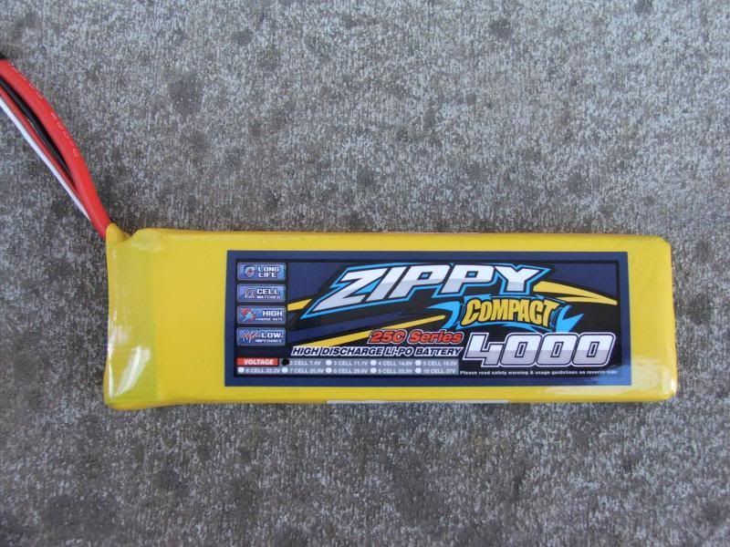

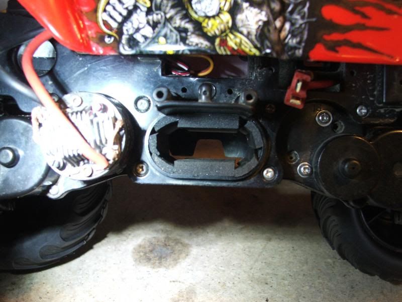

I also picked up a couple of 2S 4000mah Lipos off Hobbyking. They only cost $13.50. I had to make them fit as they were smaller than the battery compartment. I used some adhesive backed high density foam. I replaced the Tamiya 106BK esc for an XL5 esc that I picked up off ebay.

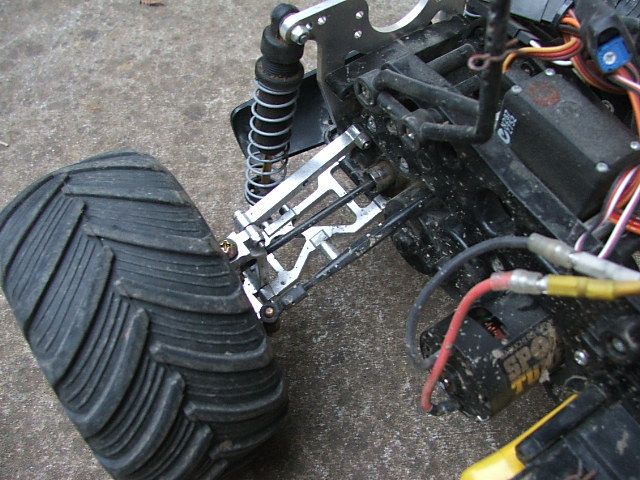

RC Damper Aluminium upper and lower aluminium arms. - got these off Ebay as well. I didn't use the pins and e-clips they came with because I could see me losing them fairly easily. I used 3mm ss hex head bolts and nylock nuts.
I already have aluminium C hubs and knuckles. Im not a massive fan of these. The knuckles are great on one hand because they all locktite to be added so you don't lose the step screws. On the downside they allow too much steering action and they allow the dog bones to fall out.
Once I installed the new alumium arms I had a bright idea.... convert to 4ws. I now had all of the components to do this. I had a spare metal geared servo, Kimbrough 124 servo saver, Servo Y harness, Junfac servo posts, a servo mount brace, two spare steering turnbuckles and a packet of step screws. The only things I didn't have was ball studs and steering rod ends. I went through my Clod Buster spares box and got these two items. I now had all that I needed. This would alleviate my problem of spitting dog bones as I could dial out the steering action seeing as though I would now be steering with the front and back.
Now for pics..........

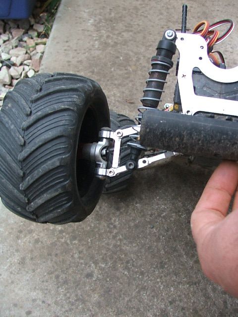

Aluminium knuckle - see the scalloped out sections allowing tighter turning radius (not a good thing in this case)

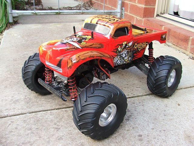

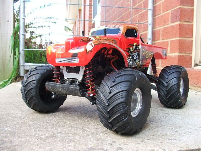

Poser shots;

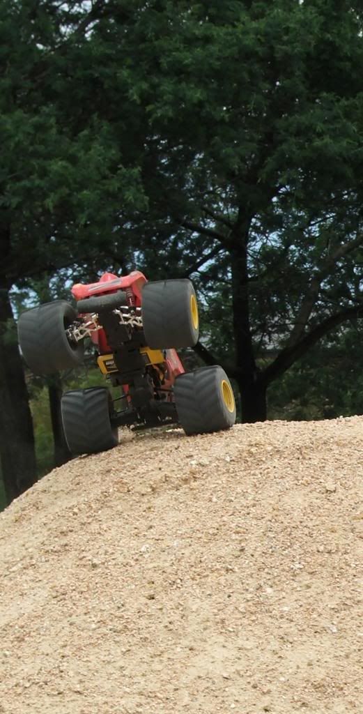

Action shot;

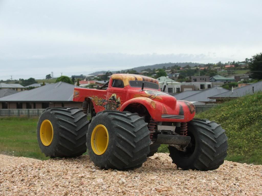

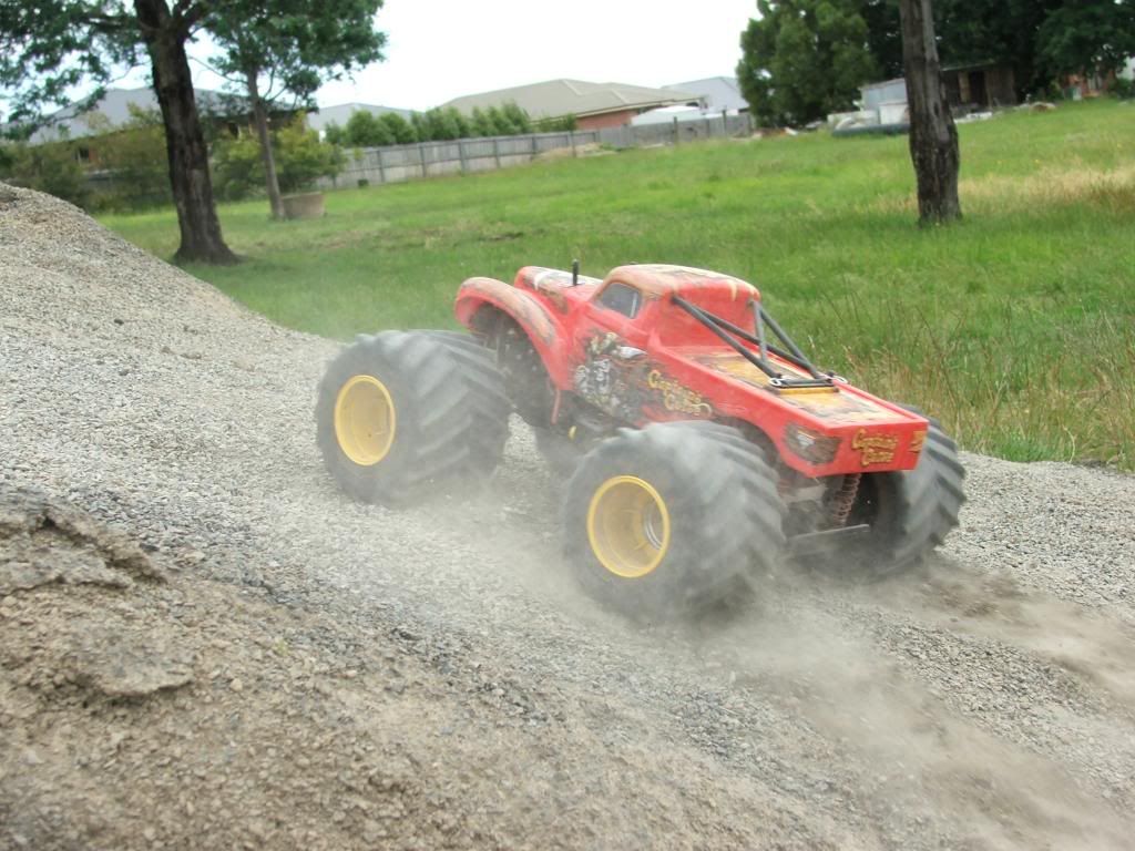

I couldn't help myself..... I just like big tyres! I made up a set of EQR wheels from some front MJ wheels and a set of original clod wheels. The clod wheels came off a project truck that I bought. One of the wheels was broken, but I could salvage the good half. They were painted yellow... I was going to paint them silver, but I kind of like the yellow! I think I will keep the truck like this now. It just seems much cooler with the big wheels. I also reaplced the junk Wraith shocks with some Associated shocks. I used red springs off Maxx shocks and added the largest pre load spacer. Handles much better now.
Posts: 11240
Re: My Wild Dagger
Post by andymac0035 » Mon Dec 09, 2013 6:44 am
I bet your going to get more than a few double-takes with that truck. Nice transformation! :thumbsup:
Posts: 1553
Re: My Wild Dagger
Post by Sixtys Guy » Mon Dec 09, 2013 9:27 am
Thanks Andy! I love this little truck. I think it is partly because I know that no one else has one!
