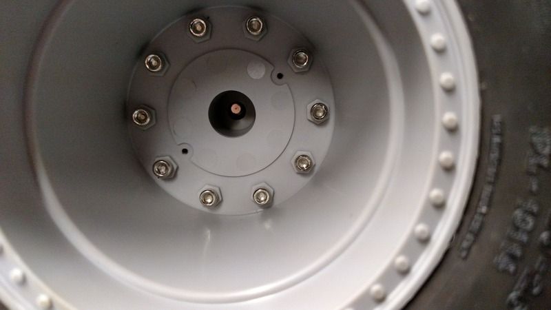

Post by SFC K » Thu Oct 06, 2016 11:54 pm
So, bad news. The rims fit and will turn without binding. The problem is finding a stub axle long enough to thread a nut onto it to tighten down the wheel. Another problem and it is miner is the hex nut that drives the wheel has a little lip in it that fits into the Brawler wheel. I tried using an aluminum hex from my SCX but they have to step ups. I think you would need a longer stub axle and a drive wheel hex that has the step up to fit the inner wheel hex solid.
I must say though, the wheel look awesome on it if you can make it work.

That's wondeful! I have super Blackfoot Axles, which are 7mm longer than stock axle. But I see and know 7mm are not enough. I could use this http://store.rc4wd.com/1x-M4-x-21mm-Bar ... p_515.html but I don't know if this works stable.
Edit: Error. Super Blackfoot axles are 7mm longer but not the M4 thread. Thread is same size as stock. :-k
I ask me how people do this on their SMT10 truck?! :?:

if you can find the barrel nut that fits properly, it should work out fine. I don't know how hard I would drive it but it should be strong enough to cruise around and do some light terrain.
