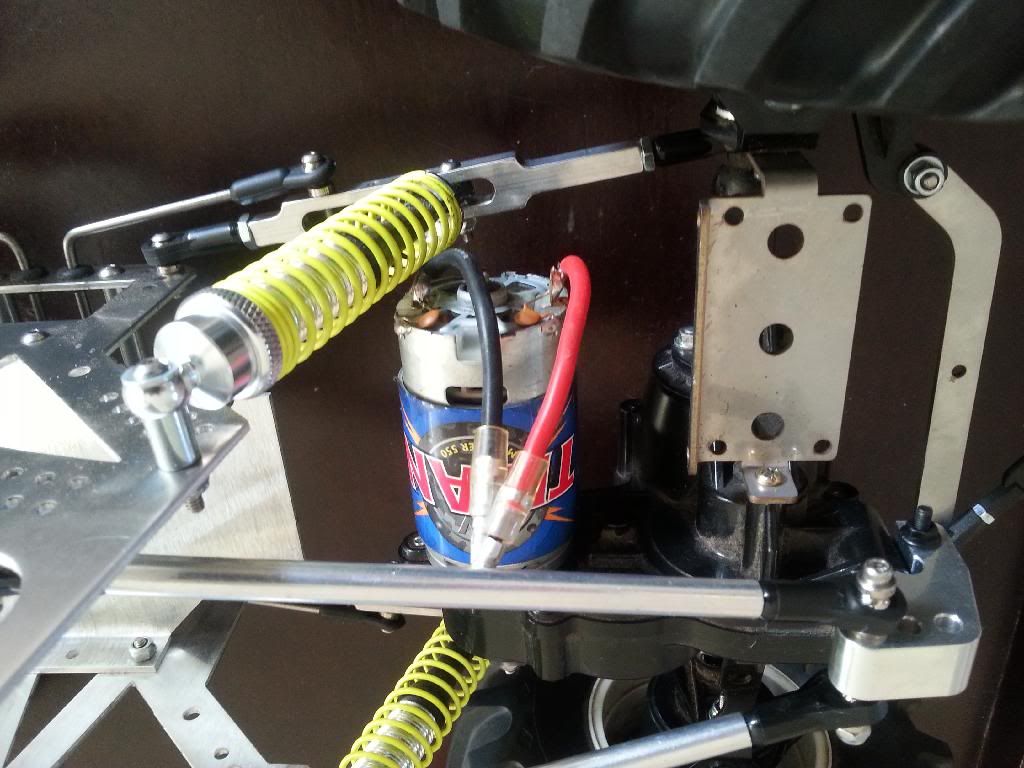

Post by NorCarLow » Fri Dec 27, 2013 3:51 am
Installed the titans/EVX2 today. I have dremel'd out the gearboxes to accept 19t pinions thought they said 18 but... Get some pics later on or tomorrow. My fears were confirmed with the ESC wires being short. Soooo... looks like some soldering in my near future. I need to also swap the BTA around. SO a little more work and I'll get there.

Post by andymac0035 » Fri Dec 27, 2013 4:13 am
Try moving the esc forward a bit, I'm running that very same se-tup and mine reach.
Some EVX-2's have longer motor leads, I unfortunately..... got the shorter ones, but as I said, mine do reach.
You did get the e-revo motor set right?....With the reverse rotation motor?
The reverse rotation motor has longer wires, letting you move the esc forward a bit, to reach the shorter wires on the normal rotation motor up front.

Post by NorCarLow » Fri Dec 27, 2013 5:17 pm
andymac0035 wrote:Try moving the esc forward a bit, I'm running that very same se-tup and mine reach.
Yeah I got that setup. Another question. Will I be able to use the servo mount that came with the BTA or Will I need to change that too?
Posts: 11239
Re: Low's Terminator
Post by andymac0035 » Fri Dec 27, 2013 5:24 pm
You can use all your BTA stuff, but you are going to have to reverse it, meaning put it all out front, instead of tucked in behind the axle.

Post by NorCarLow » Fri Dec 27, 2013 6:47 pm
andymac0035 wrote:You can use all your BTA stuff, but you are going to have to reverse it, meaning put it all out front, instead of tucked in behind the axle.
Thanks Andy.
Only thing with moving the ESC forward it will be in the way of my batteries. It would be okay if wasn't going to run to (2) 2s Lipo batteries. Maybe you could post a pic of your setup do I can an idea? I can solder like a welder welding so I can extend the wires on the motor. It might give ma neater
As you can see by the pic they are really short
