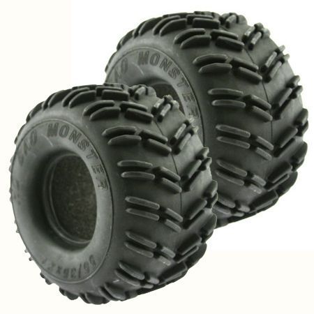

They mount directly to the 12mm hex nut and look like they could use a scosche more room once the tires are installed. (2.2" ripsaws -- 0.5" drop"). Thanks.
Update: Scratch the Ripsaws! Just found these on your website.
Much better dimensions. Ordered 4.
