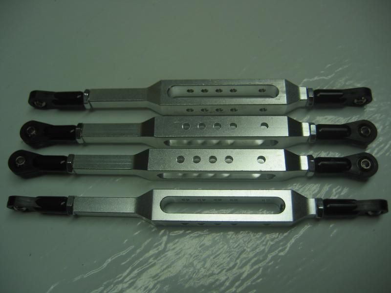

I'm completely ready to give up. after thrashing on the truck all week, trying to get it ready for Connecticut next weekend, this happens on the first test run. Nosed off a small jump, and I noticed it wasn't tracking straight... I guess no racing for me. :(

ouch! Are those the newer thicker CPE lower links?

Do you have a picture of the whole truck from the side? I'm thinking the way you mounted your shocks caused to much down force on the lower arms.

^^^ I bet not.... that's got lawn-dart/face-plant written all over it.
Axle-mounted shocks and steel links are the only way to get away from that happening.
Oh... and those don't look like the newer design links BTW.
These are the newer heavy duty design.

Wow, those are definitely thicker than mine, why would I get the old ones with a kit I just bought? :oops:

call Brett up, I am sure he will make it right with you. There's a reason he needed to do a newer design... because the old ones bend and break. I have done it with little effort myself. You are not a terrible driver... "you have to say that once in a while."
