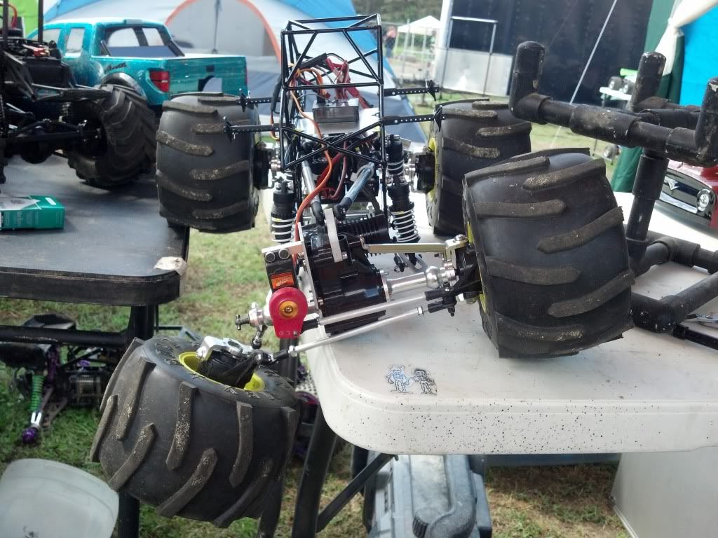

All I'm going to say is KAAAAABBBBOOOOOOOMMMMMMMM!!!!!!

:shock: I think Justin just got knocked out of the running for the next kaboom! champion.
Nicely done sir! =D>
Did you not have an axle brace on that side? :?:

I dont think that he could have one because of the servo being in the way. :thumbsup: :thumbsup: =D> =D> =D>

Right charlie! Servo mount in the way but that's not what happened.... the axle tube where its screwed together came apart mid run....I guess that's an Andy approved kaboom!

andy420ny wrote:Right charlie! Servo mount in the way but that's not what happened.... the axle tube where its screwed together came apart mid run....I guess that's an Andy approved kaboom!
I think some loc-tite would have prevented that. Metal on metal= Loc-tite.

Yea they came per assembled and made the mistake of assuming they were loc tited already but I just put some longer screws with nuts on and I'm back up and running!!
